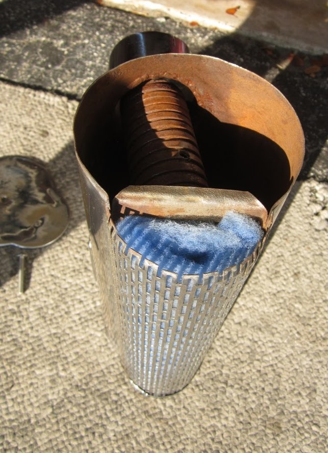

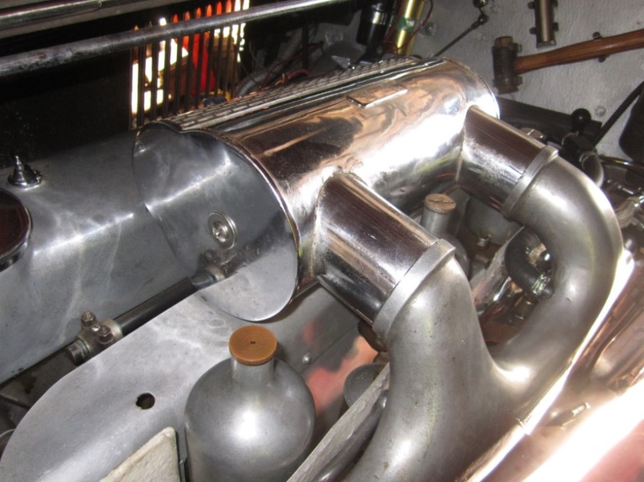

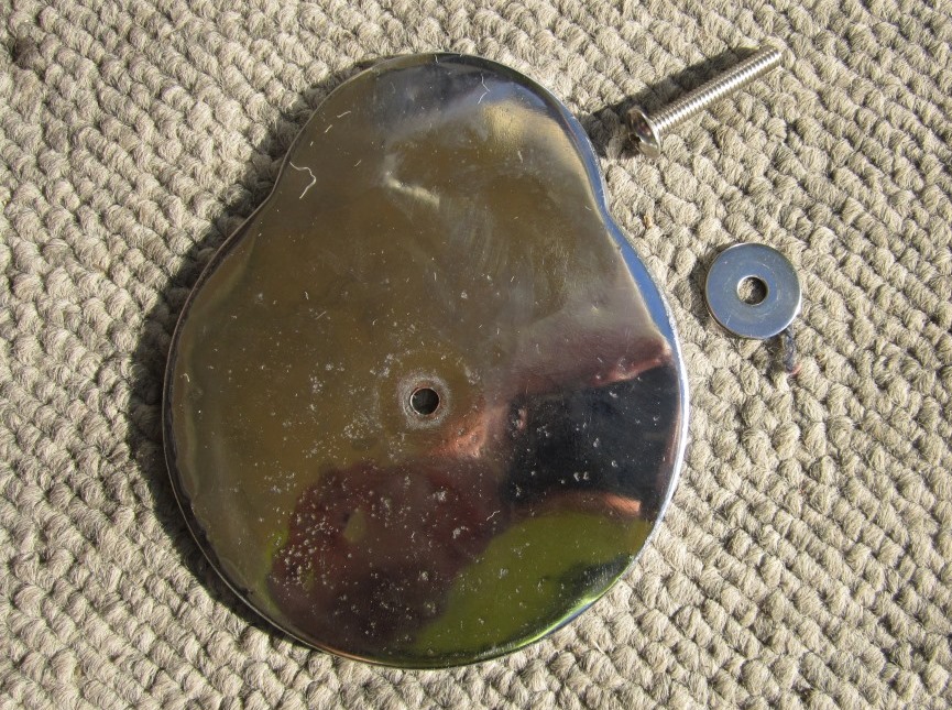

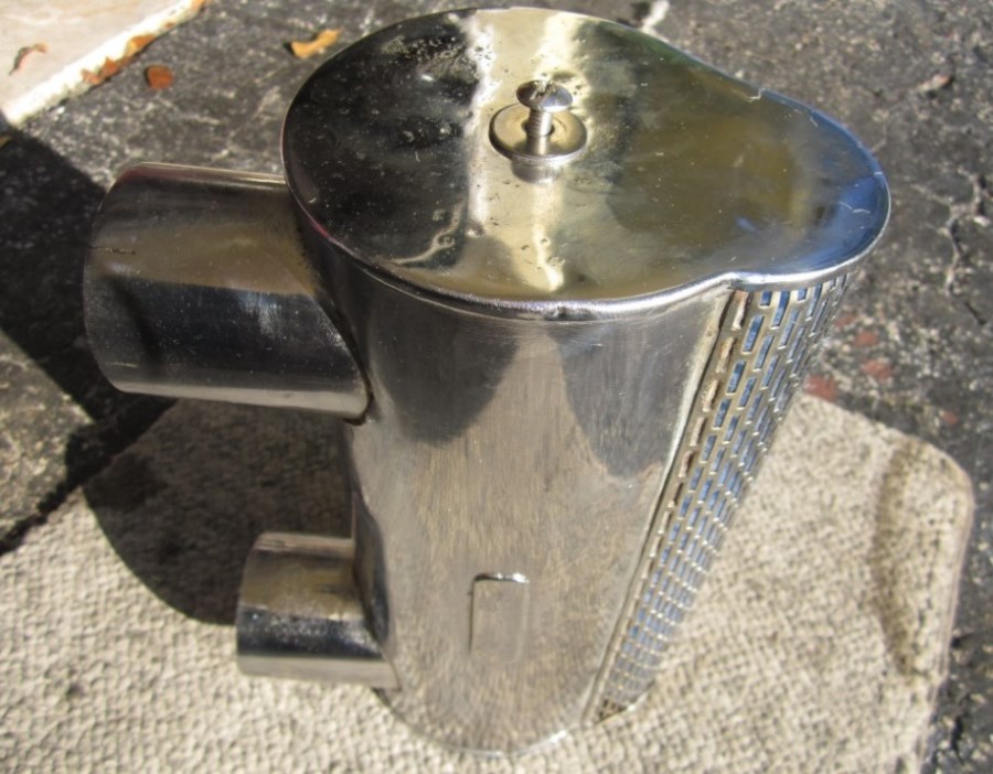

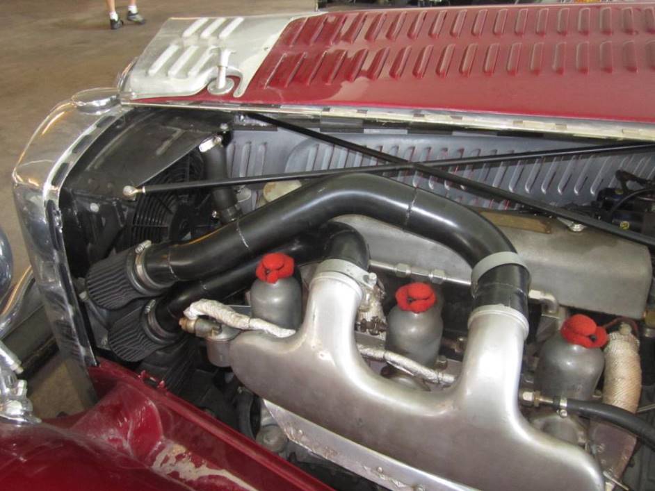

Are you interested in modifying the original Blundell Silencer to be an effective filter, or replacing it with a modern two filters system? I've done both and will be happy to post pictures of both if I can remember how!

OK, I have a total of 8 photos to post to show the two different alternatives I have tried. To begin I'm posting just one photo as it seems to be very large. Can a reader advise how to reduce in size so I can post all 8?

More photos of the the two modern filter, and modified Blundell Silencer alternatives. I now run the modified Blundell Silencer which obviously looks more period correct.

Another alternative for consideration. Not my SP25!

Thanks very much for the photos....did either mod make any diference to the running of the car?
REgards
Simon
johnlayzell
Posts: 151
Joined: Mon May 21, 2012 2:44 pm
Re: Speed 25 air filter conversion
Postby johnlayzell » Wed May 24, 2017 1:42 pm
Nothing perceptible that this driver can determine!
